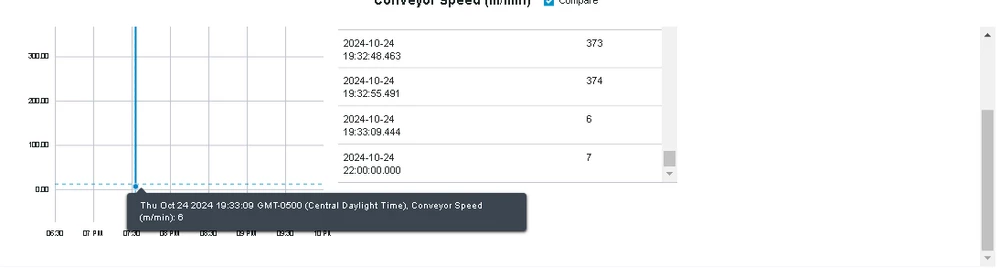

Hi PTC Community,
I'm currently facing an issue with the line chart in ThingWorx. Occasionally, the line chart fails to plot the last data point from the dataset. This happens inconsistently, and I haven't been able to identify a clear pattern or cause.
Here are a few details about the issue:
  • The dataset is correctly populated, and I have verified that the last data point exists.
  • The issue doesn't occur every time but happens sporadically.
  • When I inspect and check the preview in the API response, I can see the last data point is present, but it still doesn't show on the chart.
  • The same data is binded to Grid and chart and i can see the last timestamp is 2024-10-24 22:00:00.000 on grid where as 2024-10-24 19:33:09.444 in linechart.
    Note - i am using ChartType as Step in linechart.
    Additionally, I noticed that when I change the start date from X time to Y time while keeping the end date the same, the graph plots correctly when using Y time as the start date.

What if you extend your X axis to the right a bit, e.g. add +1 hour to it?
Nov 5, 2024 11:29 AM UTC
I have tried extending the X-axis by setting the maximum to the last data point plus one hour, but this still does not resolve the issue.
18-Opal
Nov 5, 2024 11:54 AM UTC
Then maybe it has something to do with the Y scale? I don't see a point at 19:33:09 either. What if you try limiting the Y max to something like 10 -- do you see all data points now?
Rocko
Nov 5, 2024 12:39 PM UTC
When you say "The issue doesn't occur every time but happens sporadically", do you mean it happens sporadically with the same dataset or with different datasets? Does resizing have an effect? Also, please always post your TWX version, it can make a difference.
Dec 3, 2024 5:54 AM UTC
Hey Rocko,
Apologies for the delayed response,
My current TWX version is 9.3.9
1. do you mean it happens sporadically with the same dataset or with different datasets ? it happens sporadically with the different datasets.
2. Does resizing have an effect ? - No resizing does not effect the chart.
Rocko
Dec 3, 2024 7:47 AM UTC
Sporadic errors are the hardest to fix. You need to find a way to reproduce the error before you can log a ticket. Try to find out if when you reload the widget with the same data, is the point still missing? Or if it happens with any browser. You can also check browser console and Show/Hide log for relevant entries. Can you create a specific data set that makes the issue occur? Things like that.
