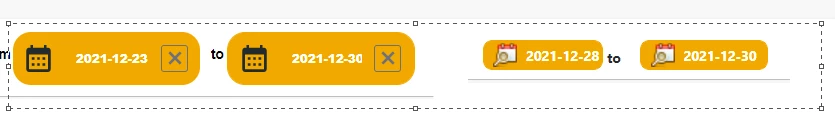

Recently I have updated my Thingworx from 8.4.3 to 9.3. I am recreating my old dashboard on 9.3 as it contained some legacy widgets. There are two issues which I am facing right now:
1. How to adjust the timestamp on x-axis for linechart. Attached image for it.
2. I want to have the same look for  date picker time.
I have tried all the possible ways to resolve it. Please suggest how this can be done

For the issue with the Line Chart Have you set the following properties:
  • HorizonalAxisLabelsRotation: Enter a value from -180 to 180 to set the rotation angle of labels on the horizontal axis.
  • HorizontalAxisMaxHeight: Sets a maximum height for the horizontal axis
  • XAxisDateFormatToken: Enter a 'DD-MM-YY' string pattern to set the date and time format for the X-axis.
online documentation: https://supportdev.ptc.com/help/thingworx/platform/r9/en/#page/ThingWorx/Help/Mashup_Builder/Widgets/RotatingTheAxisLabels.html

Hi @PEHOWE ,
Regarding charts, HorizonalAxisLabelsRotation : I have set it to 0, as I want it to be horizontal itself and X-axis format is "YYYY-MM-DD HH:mm:ss". I don't want to slant the in any degree, as it will increase the length of my mashup.
Thank you!
