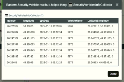

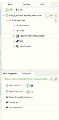

I managed to use openstreet map to show some locations of vehicles from infotable (attached) , as you can see i use get properties to be able to use the "automatically update values when new values are available" check box, but the result is really bad, first whenever the infotable data updated the whole map refresh like it shows me a white screen then it load the map and the location as i did refresh the whole page , i wanted to only move the points on the map, also it doesn't show all the locations, sometimes all of them shown, sometime some of them, sometimes none of them, i don't know how to debug it , maybe it shows the ones that has data change, i don't know what is going on honestly, if there is a better way to refresh the data in the map widget please explain it to me,
form the infotable i use the LatitudeLongitude property of type "location"

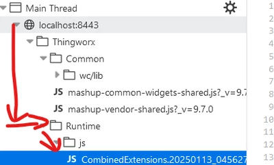

Debugging the widget is not that complex: in the Developer Tools you should be able to set a breakpoint in the code area you need. The file you need to go into is located here:
