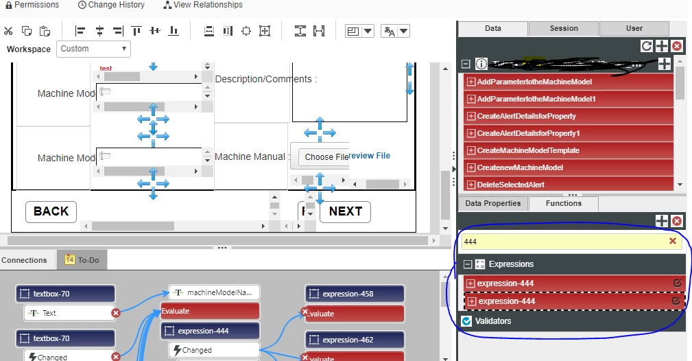

Also i found one more bug, single expression function which i used repeated two times in my mashup.
I have attached the image for your reference.

I have also seen same problem with expression widget.
It overwrites another expression with the same name you recently edited/created.
Seems not properly tested before release of ThingWorx 8.4.
