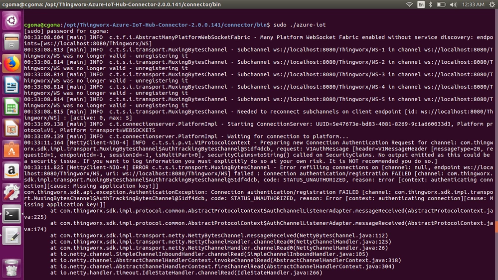

Issues while connecting azure iot hub and thingworx
I am following the resource guide
https://developer.thingworx.com/en/resources/guides/azure-iot-hub-connector-quickstart
to connect between azure iothub and thingworx.
I am using the setup as follow, I have connection server and the thingworx foundation install on the same machine.
I have edited the config file of connection for azure as well as thingworx foundation. I have added the appKey and thingworx host and port in "transport.websockets" section
transport.websockets {
// ThingWorx platform application key
app-key = "0d277e85-944d-4e85-8ec6-2c16a903c74e"
// One or more platforms can be specified here, comma separated
platforms = "ws://192.168.43.77:8080/Thingworx/WS"
But when I am running the connection server using the precompiled I am getting the error as shown in screenshot
Please let me know if running connection server and twx foundation on same machine is causing this issue.
Let me know if someone faced similar type of issue.

Hi @cgoma.
Please provide the azure-iot.conf file for further review.  You can mask any sensitive data.

cgoma1-VisitorAuthor
October 20, 2019
Hi @slangley
Thanks for your reply.
Please find attached azure-iot.conf file for your reference.

Hi @cgoma
We are able to connect between TWX an Azure, but we are using TWX 8.5 and IoT hub connector 3.0.
Configuration method is different for IoT hub 2.0 & 3.0.  It will be helpful if you share cxserver log file also.

@cgoma You'll get the same error if the app key does not exist, double-check if it is correct.
November 21, 2019
@Constantine
I did not find any issue with the application key. I double checked it and I had used the multiple application key.
