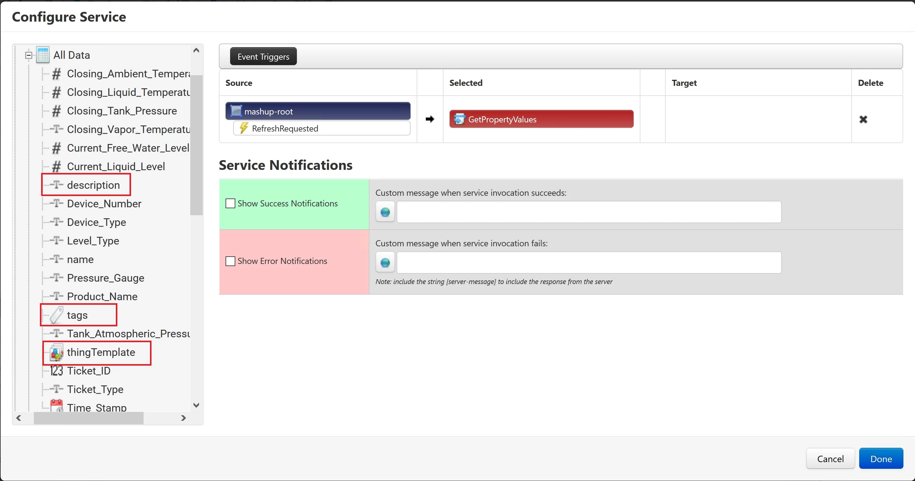

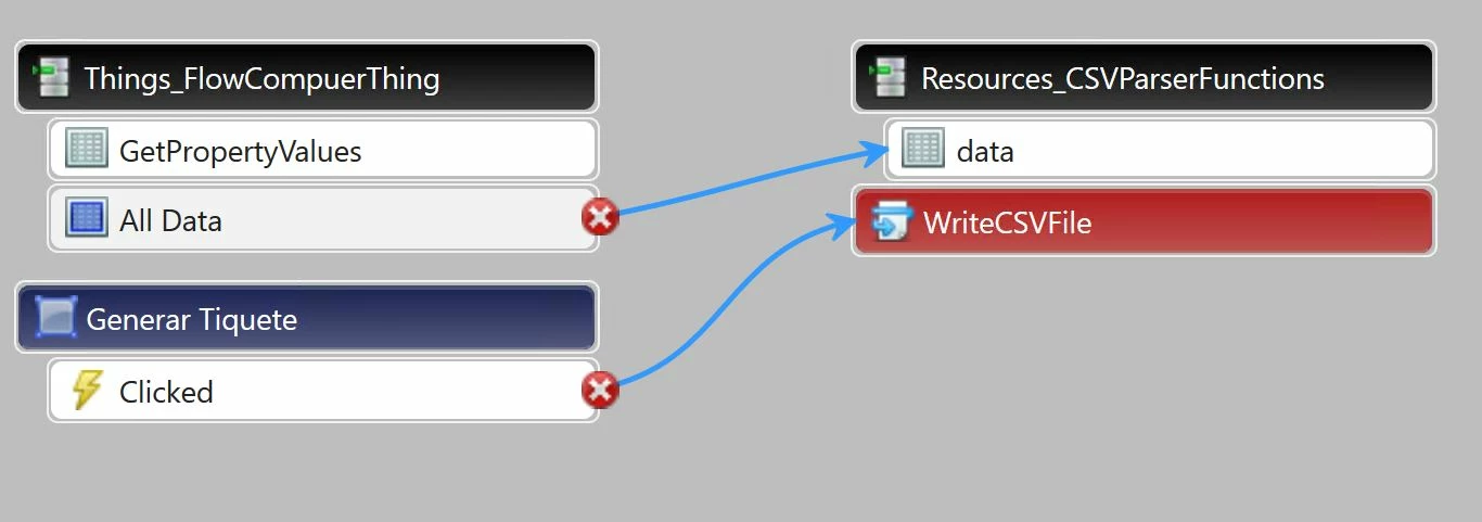

I'm creating an application for tank measurement, then I'm generating a CSV file with data from a Thing with service GetPropertiesValues, Is there any way to hidden the generic properties and only binding my properties?

Ok it ate my code example it seems to not like javascript in this field
but you just create a new service on your Thing
call GetPropertyValues from that service
use RemoveField to drop columns
set your output to result
also you should create a DataShape to match what you want to put out.

Create a wrapper service that removes the fields (or assign to a datashape that doesn't have the fields)
