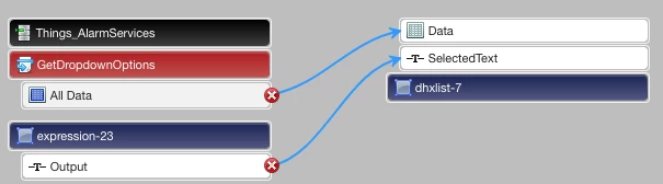

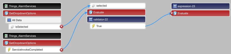

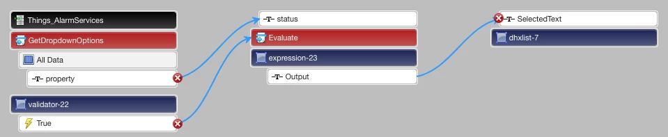

I have a list which selection I want to specify on load using the "isSelected" property, as well as a validator and an expression. However, this only works for the first row of data returned by my service, is there a way to iterate over the returned data in the mashup so that my validator checks all rows of returned data?
returned infotablereturned infotable
validator checks it isSelected is truevalidator checks it isSelected is true
if isSelected is true, expression takes selected propertyif isSelected is true, expression takes selected property
selected property is set as selectedText in listselected property is set as selectedText in list
list with specific selection on loadlist with specific selection on load
