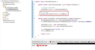

You can reproduce it.
I downloaded your completed "MyThingworxWeatherExtension" example ExtensionSampleFiles.zip from this tutorial Create An Extension.
I'm still getting an empty InfoTable.
Added new class InfoTableCreator with the code below:
package com.thingworx.weather;
import com.thingworx.metadata.DataShapeDefinition;
import com.thingworx.metadata.FieldDefinition;
import com.thingworx.types.BaseTypes;
import com.thingworx.types.InfoTable;
import com.thingworx.types.collections.ValueCollection;
public class InfoTableCreator {
	public static void main(String[] args) throws Exception {
		// Create InfoTable
		InfoTable table1 = createInfoTable();
		// => null
		System.out.println(table1.toJSON());
	public static InfoTable createInfoTable() throws Exception {
		DataShapeDefinition ds = new DataShapeDefinition();
		ds.addFieldDefinition(new FieldDefinition("field1", BaseTypes.NUMBER));
		InfoTable table = new InfoTable(ds);
		ValueCollection row = new ValueCollection();
		row.SetNumberValue("field1", 1);
		table.addRow(row);
		return table;

May 17, 2022 5:29 PM UTC
You are not able to execute/test your logic without having it deployed in ThingWorx. If you deploy the extension you should see the result (if it works - I did not check the code).
The extensionSDK just has Dummy implementations - so Infotable.addRow(x) has no implementation. As well as toJson has {return null} as implementation. It just does nothing. A real pain for (unit)testing anything. If deployed in the platform the real implementation will be used.
(That was the state when I last checked it more than 1 year ago)
