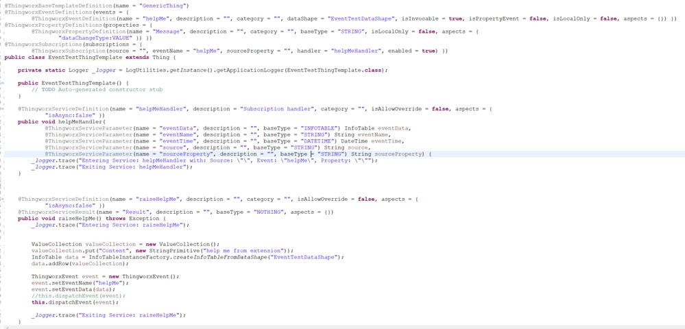

I have the following event, Subscription and Service defined in JAVA extension.  Executing the Service raise the event "raiseHelpMe", but the handler helpMeHandler is NOT called.  and I didn't find  the log "Entering Service: helpMeHandler" .
Thingworx: 8.3.4
=============================Code========================================
=====================application log===============================================
2019-02-18 19:43:22.148  Debug Completed event processing for : Event.helpMe on behalf of   c.t.s.s.e.EventInstance TWEventProcessor-14
2019-02-18 19:43:22.148  Debug Completed execution of event : Event.helpMe on behalf of Administrator c.t.s.s.e.EventInstance TWEventProcessor-14
2019-02-18 19:43:22.148  Debug Starting execution of event : Event.helpMe on behalf of   c.t.s.s.e.EventInstance TWEventProcessor-14
2019-02-18 19:43:22.148  Debug Starting event processing for event : Event.helpMe on behalf of   c.t.s.s.e.EventInstance TWEventProcessor-14
2019-02-18 19:43:22.148  Trace Exiting Service: raiseHelpMe Administrator c.t.w.EventTestThingTemplate http-nio-8080-exec-8
2019-02-18 19:43:22.148  Info Firing event Event.helpMe with 1 subscribers Administrator c.t.s.s.i.SubscriptionStoreInMemoryThreadSafe http-nio-8080-exec-8
2019-02-18 19:43:22.148  Trace Entering Service: raiseHelpMe Administrator c.t.w.EventTestThingTemplate http-nio-8080-exec-8
2019-02-18 19:43:22.148  Debug Executing request [URI: /Thingworx/Things/EventTestThing/Services/raiseHelpMe] Administrator c.t.w.BaseService http-nio-8080-exec-8
2019-02-18 19:41:46.585  Trace Entered addSubscription for publisher EventTestThing and subscriber EventTestThing and event Type.Thing:Entity.EventTestThing:Event.helpMe Administrator c.t.s.s.i.SubscriptionStoreInMemoryThreadSafe http-nio-8080-exec-5
