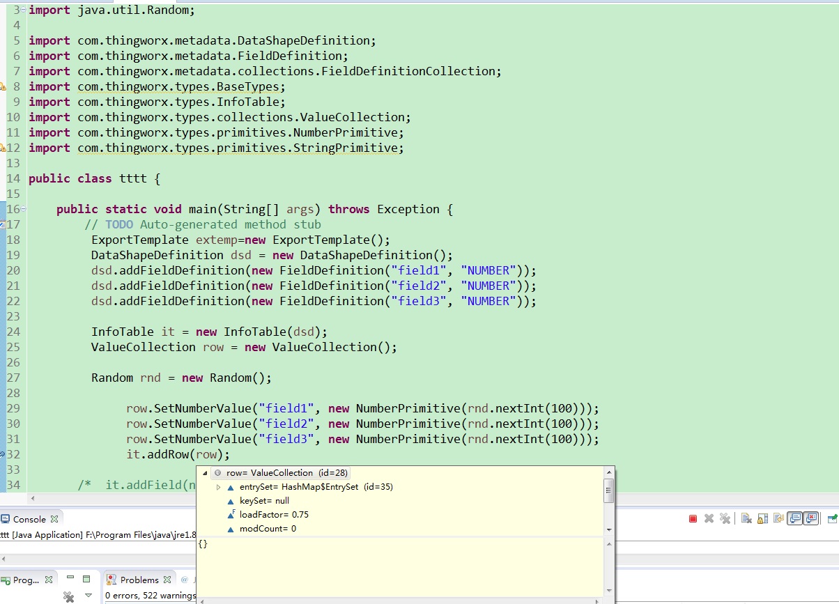

Java: InfoTable addRow of ValueCollection puts empty
   as the picture,i am trying to add one row number to an infotable ,but the row always setvalue null,
What am I doing wrong or making a wrong assumption on setvalut to a row?
Much appreciated for everyone that is able to contribute.
Cheers
fliu11-VisitorAuthor
December 19, 2017
the thingworx sdk is version 7.1.0
December 21, 2017
Hi Fen, not sure if you have already seen this but could you check if this helps Re: Java: InfoTable addRow of ValueCollection puts empty this looks like similar question. Please feel free to correct me if it's not so
January 3, 2018
thanks for your answer, i import the sdk of version 6.X to solved the problem
