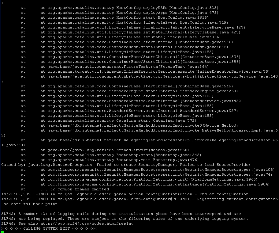

Hello everyone,
I am actually trying to migrate Thingworx 8.4 to 9.3 an i am facing an issue.
 I actually saw that you cannot migrate from 8.4 to 9.3 i have first to set Thingworx to the 9.0.3 version.
I am using:
JDK -> Amazon corretto 11
Postgresl 13.
Tomcat work perfectly fine and i m facing that issue when i tried to launch my service.
I have already checked this article:
https://www.ptc.com/en/support/article/CS305796
Afiter checking the point step by step, i can confirm there is actualy no answer for my situation,

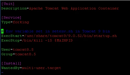

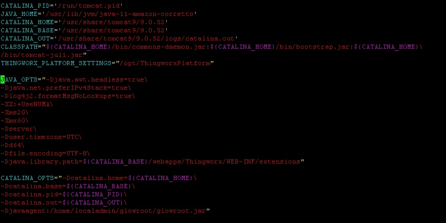

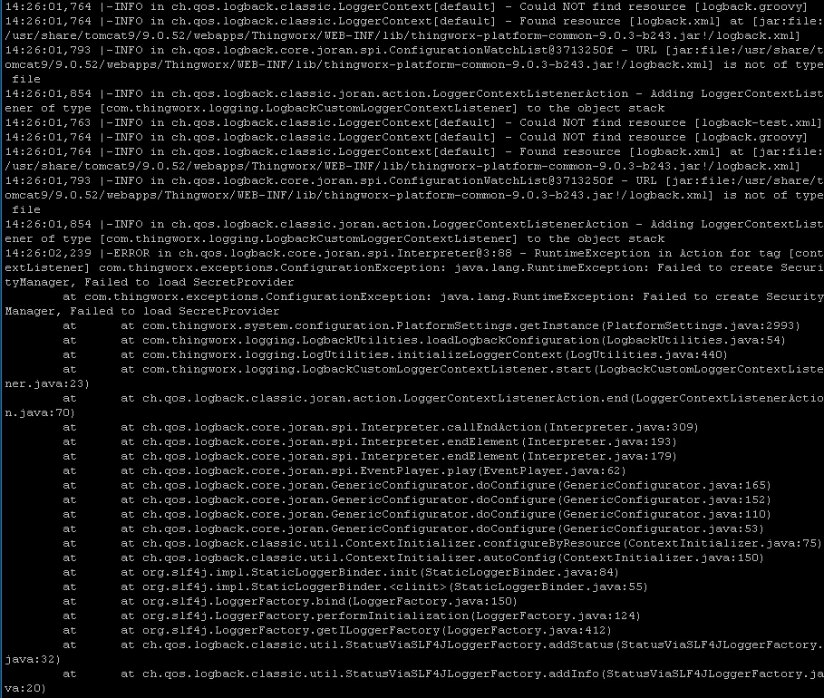

I join you the main informations from the stack trace, my linux service config and my setenv.sh.
in screenshot format.
(All the rights and ownership  have been setted for tomcat8.5, which is the user of the service)
Thanks for your time,

As you have checked the points mentioned in the article https://www.ptc.com/en/support/article/CS305796 , the issue might be related to the corrupted trust store in your upgrading system. I would suggest you to open a case to Technical Support to look at it via remote session
