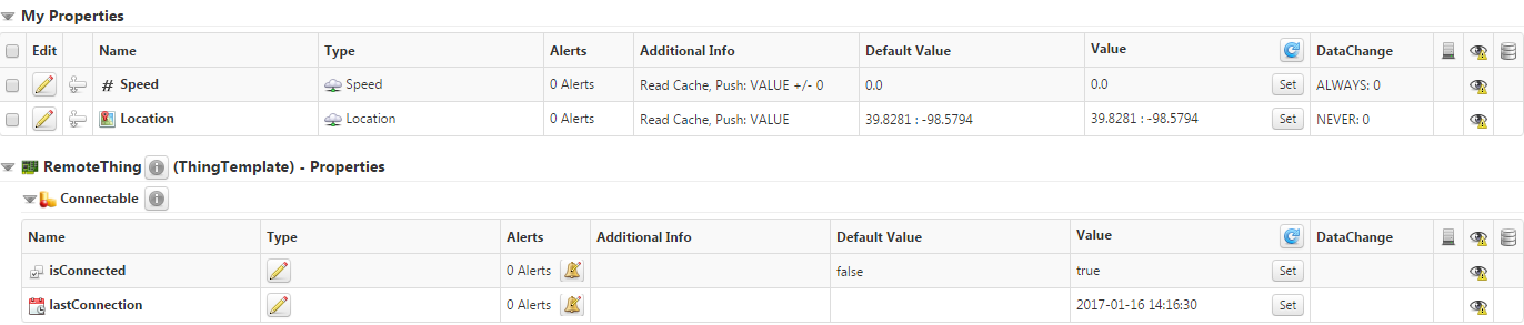

I´m an absolute beginner in ThingWorx.
I started with PTC University Introduction to ThingWorx 6.5 courses.
In Part 4 there is a "Binding to a Remote Thing and Logging Its Values" challenge.
If I try to solve this challenge I get that error:
My remote Speed property dont change,
Anybody has an Idea what is the problem in this case ?
Many thanks in advance.
