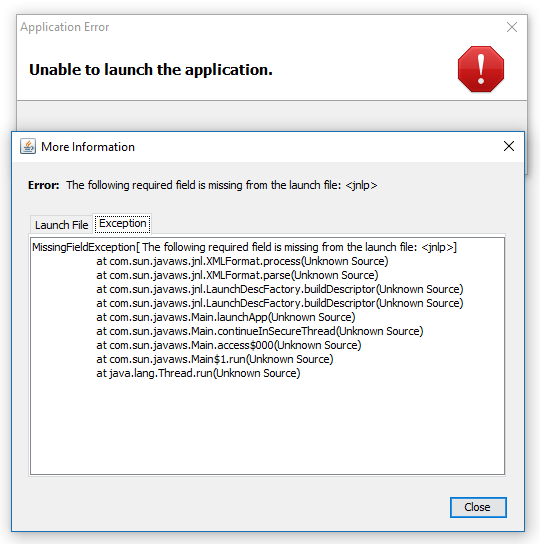

I am trying to set up tunneling in my Java App for Remote Desktop purposes.
Background:
  • Java SDK 6.1
    • Netty 4.1.21 ?
  • ThingWorx 8.0/8.1
  • UltraVNC
Java App Configuration:
twxClientConfigurator.setUri(AppProperties.getAppProperties().getProperty("thingworx.uri"));
twxClientConfigurator.setAppKey(AppProperties.getAppProperties().getProperty("thingworx.appKey"));
twxClientConfigurator.ignoreSSLErrors(true);
twxClientConfigurator.tunnelsEnabled(true);
On the ThingWorx side everything is configured as it should be:
The Error which I am receiving, while trying to download wsadpater.jsp file:
An the ThingWorx logs:
Remote access attempt failed for tunnel name vnc on remote thing Remote access attempt failed for tunnel name vnc on remote thing mything. mything does not support tunneling.

I am ashamed about it, but I found the source:
Instead of this:
this.createTWXClientConfig();
thingClient = new ThingClient(this.twxClientConfigurator);
I was doing this:
Now the fun part:
In createTWXClientConfig() method I was setting up URI & appKey. In both cases I was able to connect to the Platform without any issues, but tunneling was not working in 2nd case...
Now everything is ok.

I feel like this is something "simple" such as the mashup is misconfigured. I will search our internal tracker and see if something simple comes up.  Double chceck that you have the mashup configured correctly and that the thing has the tunnel configured etc. I'll follow-up in a bit (if nobody else does)
Feb 7, 2018 1:29 PM UTC
One more place to check is in %userprofile%\ThingworxRemoteAccess\thingworx_tunneler.log (assuming windows, $HOME if not). is there anything helpful in there?
