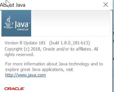

I downloaded the 8.3 version and tried to install by running: twxFoundationH2Trial-8.3.2-windows-installer.exe
I immediately get an error telling me to install the proper version of Java.  I looked up in the system reqs which states you need to have Java 1.8.0_92-b14 64 bit.  i have Java 1.8.0_181-b13 and need this version for other installed software.
Can I do an install with the 181 version installed?
-Rob

In most cases, it is the stated version OR HIGHER.
Try it and see.
The place we get in trouble with Java is one program wants 1.6 or 1.7 and Windchill wants 1.8.

That is what I was hoping but I can't do the install.  It fails right after the PTC logo saying to install required version.
 (see attached screen shot)
When I run my Java config... About I get:
There is no way to get past the error to do the install.
