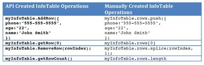

In addition, below is a table that demonstrates InfoTable helper functions versus manipulating the .rows array directly:
Best regards,
Raluca Edu
