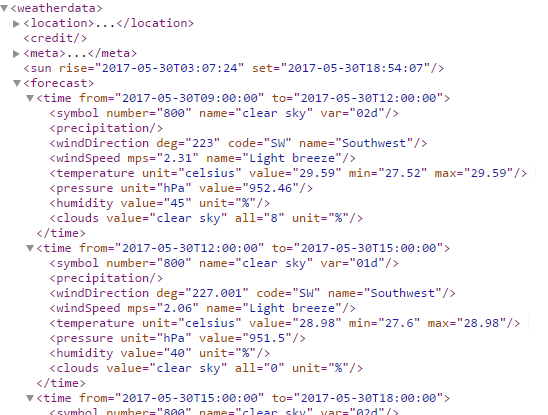

Here is the xml-response of the given request:
request-URL: http://api.openweathermap.org/data/2.5/forecast?q=linz&units=metric&type=accurate&mode=xml&APPID=ef67184baece136977466e7894b2a614
one part of the response: ( i have shortened it a bit)

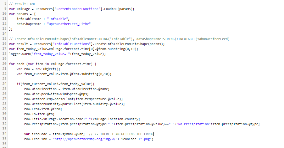

I want to retrieve all iconCodes of all forecast-days. (And it works fine with the temperature, wind direction, etc...
a part of the function which should get the data from the webservice:

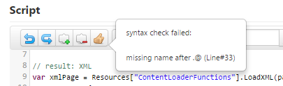

If I add the line var iconCode = item.symbol.@var, I get the following syntax error:
I think I get the error because "var" is a reserved string in JavaScript. But how do I get the iconCode from the xmlPage then? Any suggestions?

I solved it this way as I wasn't able to convert the replaced string back to xml.
var iconCode = item.symbol['@var'];
