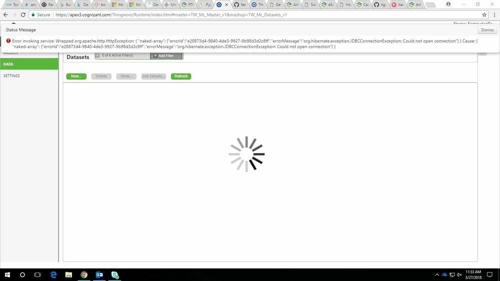

JDBCConnectionException: Could not open connection error whice accessing Analytics Builder 8.0.0
Iam getting the following error:
Error invoking service: Wrapped org.apache.http.HttpException: { "naked-array": {"errorId":"4f317b51-1a21-4f77-95f0-c96e0b2fa185","errorMessage":"org.hibernate.exception.JDBCConnectionException: Could not open connection"} }
when i try to access DATA tab in Analytics Builder

I was able to solve the issue.
The issue was due to conflict between two postgressql versions installed in centos.

Hello.
This could have a number of different causes; could you open a case with Technical Support, please?
Thank you,
-- Craig A.
Mar 29, 2018 6:15 PM UTC
Hello @bhargav,
Have you reviewed the Knowledge Article below?
https://www.ptc.com/en/support/article?n=CS265097
If this does not resolve your problem, as my colleague @CRArko indicated, a case may be required as this behavior can be caused by several different issues that would require more in-depth review.

Sorry for late reply,
I will open a case with Technical Support.
Thank you for the article and support.
bhargav1-VisitorAuthorAnswer
Apr 12, 2018 6:07 AM UTC
