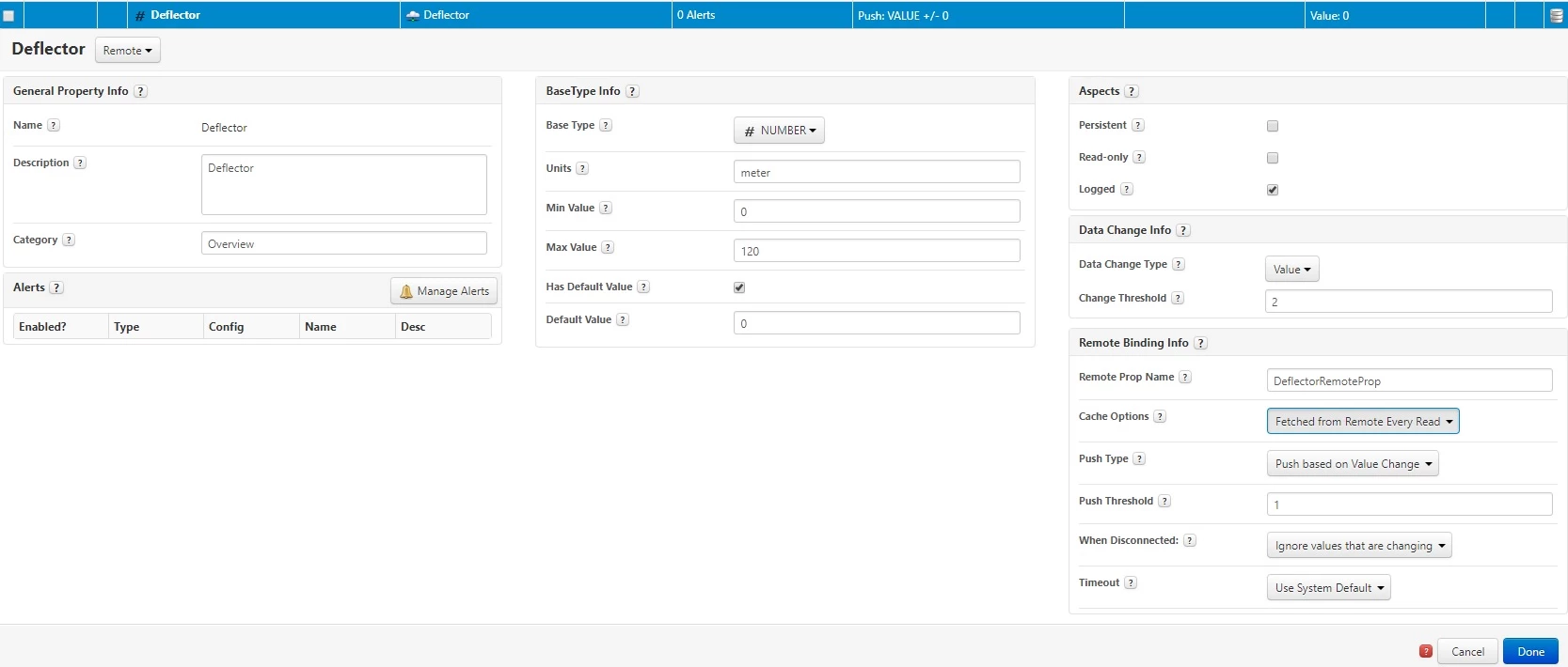

I have a template with field like "Deflector" of NUMERIC type (and other properties not show in above image).
I would like to create a JavaScript service that will based on template name return a collection of JSON objects
containing all property information that can be seen in the image.
I want to build agent with a VirtualThing implementation that will be based on this JSON configuration that can be retrieved from the TW JS service.
In addition I would like to add "custom aspects" like: System, Group and Model that can be associated with each property (Can I use some kind of linked DataTable that I need to maintain using a custom mashup where I would show property names in one column, hide ThingTemplate name (which will point to TT name) and add DataShape columns: System, Group and Model). Can this be achieved differently?
"Name": "Deflector",
"Description": "Deflector",
"Category": "Overview",
"BaseType": "NUMBER",
"Units": "meter",
"MinValue": "0",
"MaxValue": "120",
"HasDefaultValue": true,
"DefaultValue": "0",
"Persistent": false,
"ReadOnly": false,
"Logged": true,
"DataChangeType": "VALUE",
"ChangeThreshold": "2",
"CacheOptions": "",
"PushType": "VALUE",
"PushThreshold": "1",
"System": "MonoLaser",   >>> Desired as extra aspect
"Group": "Optics",            >>> Desired as extra aspect
"Model": "ML4000",          >>> Desired as extra aspect
I tried these service calls: GetRemotePropertyBinding, GetNamedProperties, GetPropertyValues, but
I don't get all information needed by the agent to build VirtualThing's properties in the constructor of inherited class anding with initialize() VirtualThing call.
I would prefer to base this service on the Template name since I would know what template VirtualThing will be using on the server. I also have ThingShapes which will be implemented by some ThingTemplates.
Thank you,
Rad

The retrieval of this configuration should come back as an InfoTable (like get PropertyDefinition or something similar or GetPropertyBinding ... )
I am not sure if you have the agent set up to use InfoTables as is, else potentially the ToJSON service can work.

Based on these links:
http://support.ptc.com/help/thingworx_hc/thingworx_8_hc/index.html#page/ThingWorx%2FHelp%2FComposer%2FThings%2FThingProperties%2FProgrammaticallyAddingPropertiestoThings.html%23
https://community.ptc.com/t5/ThingWorx-Developers/Set-Property-Units-field/td-p/539958
We can create remote-bound property on a thing template using AddPropertyDefinition  service.
I cannot see how to programmatically set these aspects:
Cache Option
Cache Interval
When Disconnected and
Timeout settings.
So is there any way to get/set these 4 properties. I thing I will be able to get other property aspects.
