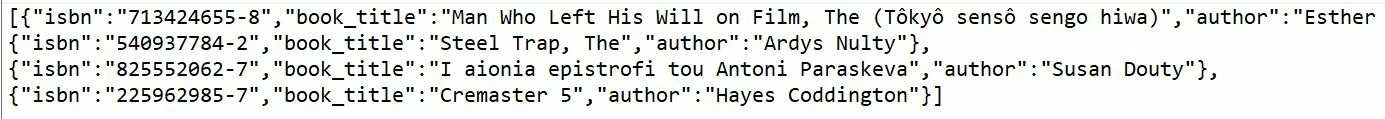

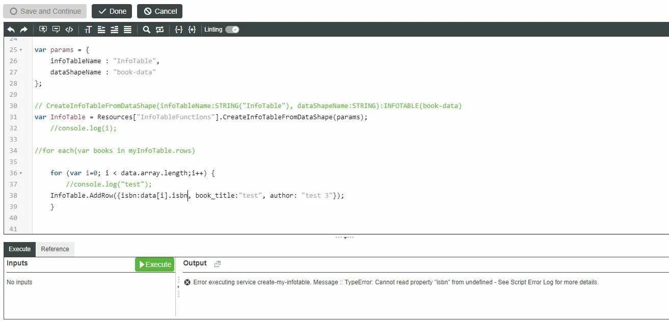

I am trying to store data being pulled in from a JSON file into an InfoTable and I keep getting this error with one of my values from the JSON file:
 Error executing service create-my-infotable. Message :: TypeError: Cannot read property "isbn" from undefined - See Script Error Log for more details.
I attached my code that was created with the help of the article: https://www.ptc.com/en/support/article/CS179012 and the JSON file.

Had you tried data.array[i].isbn?
Maybe better you print the JSON content to the log console:
logger.info(" JSON content "+JSON.stringify(data));

Hi! How/where is your "data" variable set? As an input to the service or as code above the screenshot?
April 20, 2020
This worked for me! Thank you so much.
