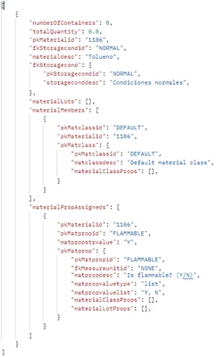

I can introduce some data to the XXX just to filter and get an específic JSON result . For example, If I write 1106 on Materialid, I will recieve the following JSON:
Ok, now, I would like to show this JSON in a table or in same way, but as I recieve a "tree" JSON with fileds inside properties (max 3 levels of the tree) from the objects, I would like to know how must be implemented in Thingworx, is there any way to save all the objects somwhere with all data under each property?Some Table? I don't know.

The output, as you can see on the picture attached is a JSON, the same JSON i pasted before, if I execute just the servide on the Thing, it works well.
So please, how can I do to save the objects i recieve from JSON ? Creating a Table? Storing it in some place?

22-Sapphire I
August 9, 2021
You will have to convert the JSON into an InfoTable in your service and use that in your mashup (you can do InfoTable inside InfoTable if needed)
