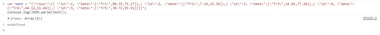

I am creating a string using concatenation of different data needed and creating the result string as below.
{"rows":[{ "id":1, "data":["Tr1",80.35,79.27]},{ "id":2, "data":["Tr2",7.24,19.34]},{ "id":3, "data":["Tr3",16.02,77.20]},{ "id":4, "data":["Tr4",44.12,51.64]},{ "id":5, "data":["Tr5",30.72,93.91]}]}
This input to JSON.parse(); gives error as "unexpected object literal".
I understand that, when the string is passed to the JSON.parse it will be in double quotes, as below
"{"rows":[{ "id":1, "data":["Tr1",80.35,79.27]},{ "id":2, "data":["Tr2",7.24,19.34]},{ "id":3, "data":["Tr3",16.02,77.20]},{ "id":4, "data":["Tr4",44.12,51.64]},{ "id":5, "data":["Tr5",30.72,93.91]}]}"
and this will fail as invalid JSON. So I am passing the string with a backslash as a prefix to the double quotes as ( \" ). so that my result String would be.
"{\"rows\":[{ \"id\":1, \"data\":[\"Tr1\",80.35,79.27]},{ \"id\":2, \"data\":[\"Tr2\",7.24,19.34]},{ \"id\":3, \"data\":[\"Tr3\",16.02,77.20]},{ \"id\":4, \"data\":[\"Tr4\",44.12,51.64]},{ \"id\":5, \"data\":[\"Tr5\",30.72,93.91]}]}"
Even this fails JSON.parse() or service keeps showing the "Executing" status. However when this same string is parsed in browser's console, it parses successfully.
In addition to above, I cannot create an Infotable and then convert it to JSON, because the column names that I have include spaces and special characters. And Thingworx doesn't accept Field Names for Datashape with Special Characters and spaces..

I'm not quite sure how you are doing this, but
the following piece works just fine (output of service is string)
var myString = JSON.parse('{"rows": [{"id": 1,"data": ["Tr1", 80.35, 79.27] }, {"id": 2,"data": ["Tr2", 7.24, 19.34]}]}')
result = myString.rows[0].data[1];
and my output is 80.35
So you should be able to iterate the object and construct an infotable.

Hello Paichung,
What I want to accomplish? - I want to create JSON for the row Data in grid. I cannot use Infotable as the headers I need for the result table have special characters and spaces and are changing continuously.
I am creating the string using the data from 2 tables within a service.
And then using JSON.parse on that string.
I tried your suggestion too. Created a Input Parameter with baseType as JSON and assigned the string variable to it. and passed to result with baseType set as JSON.
Also This time, I added logger.warn() to create log messages.
One Thing I noticed, the service execution is completed, but the window keeps on showing Executing bar continuously. Same happened when I tried with JSON.parse() and your method too.
This clears that there is no issue with the JSON.parse(), actually the Executing message that appears continuously.
How can I make sure, that this will not affect when using in mashups anyway.
