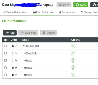

Step 1 : Create a Datashape with the required fields
In my case field1, field2, field3 are JSON keys
Step 2: Create an InfoTable and add a row to it
var jsonValue = {
 "field1": 20,
 "field2": 30,
 "field3": 40
// CreateInfoTableFromDataShape(infoTableName:STRING("InfoTable")
let result = Resources["InfoTableFunctions"].CreateInfoTableFromDataShape({
 infoTableName: "InfoTable",
 dataShapeName: "testShape"
result.AddRow(jsonValue);
/VR

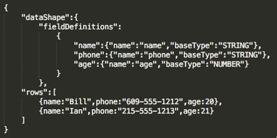

Jan 17, 2024 3:56 PM UTC
If you want to use,
 var infotableData = Resources["InfoTableFunctions"].FromJSON(jsonData);
Make sure the jsonData is in correct infotable JSON array format e.g. it has rows key with array of data meant to be the infotable rows and the data shape info as object.
(Source: PTC)
You can use this with an actual datashape fields or even without one. just make sure the json is in this format.
