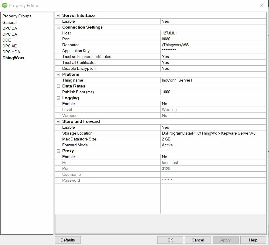

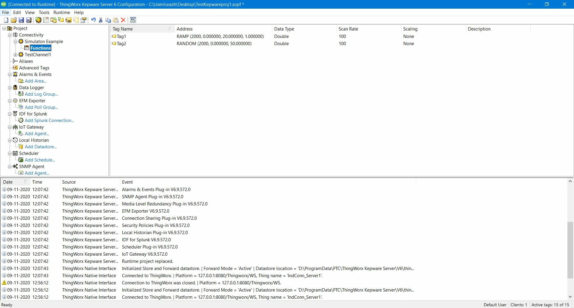

I just started using Thinkworx and I am trying to get all the tags from Kepware Server to a Thingworx Foundation. But Kepware tag value is not updated in Thingworx Foundation. When I refresh "Industrial Thing" in Thingworx, the value is not updated.
Kepware Server version: 6.9
Thingworx Foundation Version: 9

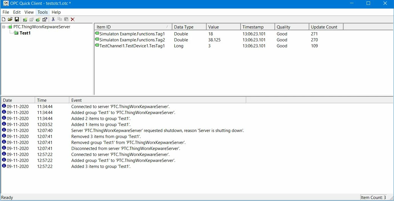

In OPC Quick Client, Tag values are updated.

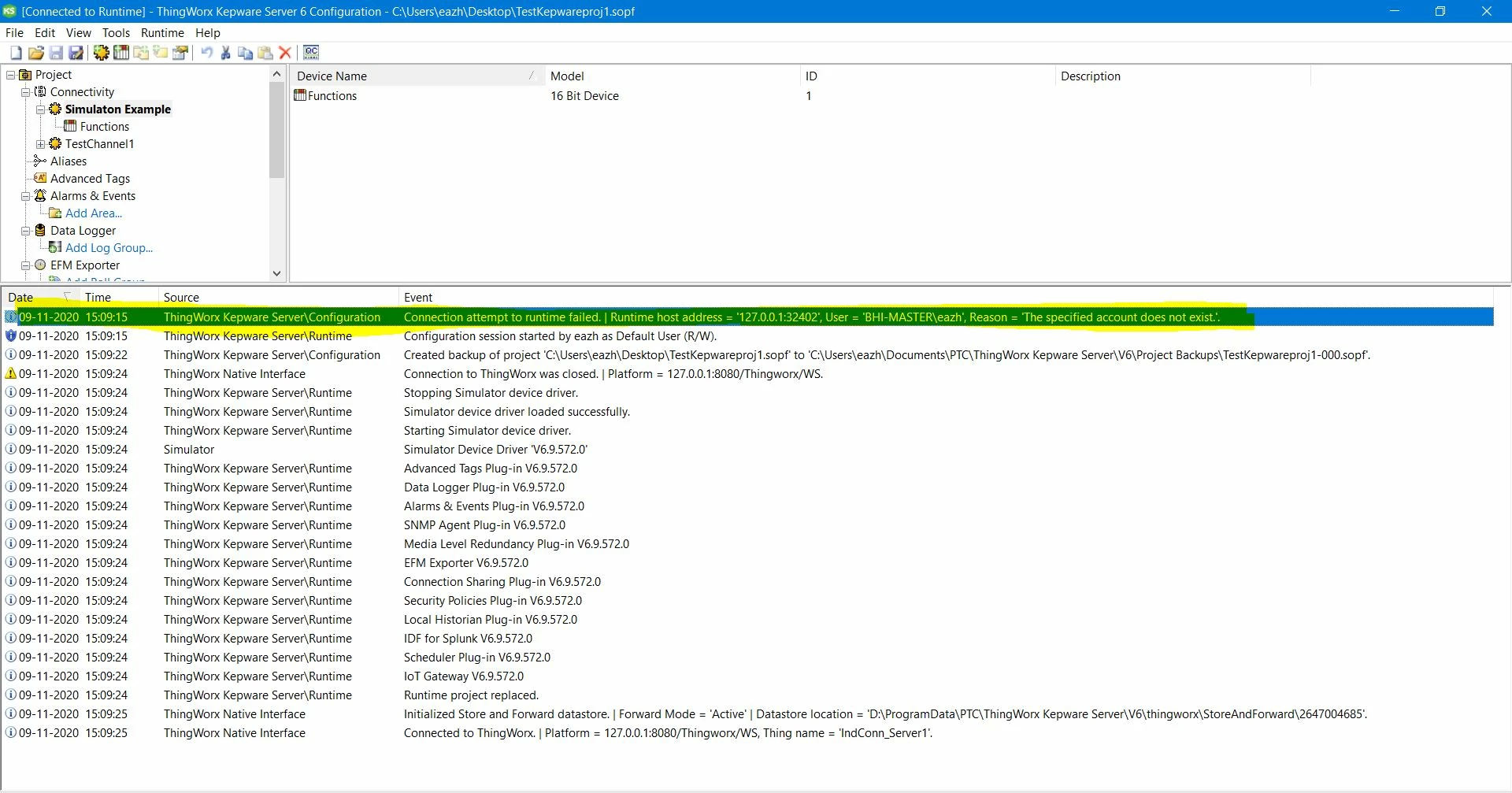

And one more thing. When I startup the Kepware server, it shows one info as "The specified account does not exist". I have attached the log details image file.

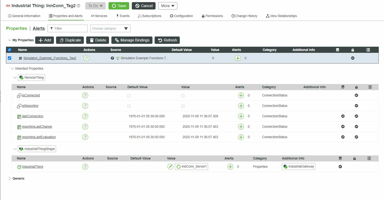

Hello @AE_9699465,
Can you check the logs on ThingWorx side for any issues with the connectivity. You can look into the ApplicationLog for any info.
Can you check the remote bindings in the manage bindings for the properties in the "Industrial Thing" ? You can redo the bindings or check the name of the tags.

Hi ,
I have checked logs in Thingworx. The following message is printed in the "ApplicationLog" file.
 [L: ERROR] [O: c.t.w.p.APIProcessor] [I: ] [U: ExampleUser] [S: ] [P: ] [T: WSExecutionProcessor-14] Unable to dispatch [ uri = /Things/IndConn_Server1/Services/BulkLog/]: Entity IndConn_Server1 does not exist or is not yet associated with a Thing
 [L: ERROR] [O: c.t.s.s.w.p.WSExecutionInstance] [I: ] [U: ExampleUser] [S: ] [P: ] [T: WSExecutionProcessor-14] error executing APIRequest Message: Entity IndConn_Server1 does not exist or is not yet associated with a Thing, sending ERROR ResponseMessage to caller!
