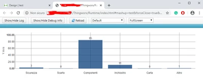

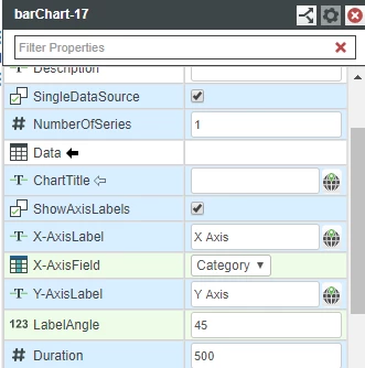

1- I'd like to change the labelangle but it's not working for me
2- Another thing in view mashup instead of showing mashup name as title I'm seeing the complete address, as you can see in the second picture.

I am not sure what is happening for you, it does work for me.
I would suggest you use strictly this code:
.nv-x .tick text{
transform: rotate(-45deg);
text-anchor: end !important;
Also you may need to untick the linting checkbox in Custom CSS editor if you have a warning that appears - see https://www.ptc.com/en/support/article/CS284203

I have tested bar chart and I could change label angle.
Try to clear cache of the browser.
In a new mashup, if you create a bar chart, can you change label angle?

If I select DataDisplay = Show Values, don't see the effect of label angle
Instead if DataDisplay = Hover, then able to see the effect of labelangle
For second if I use the chart extension widget in the mashup, then title of the page is the complete link as follows
instead if the mashup is without bar chart extension widget, it's fine

 For your second issue it seems that is an issue coming form the chart extension, see https://www.ptc.com/en/support/article/CS319558
