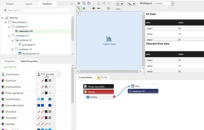

I am using thingworx 8.3 to build my thingworx application, I recently upgraded to thingworx 8.5.4. Everything works correctly except for the label chart widget.
Attach label chart picture before and after upgrade.
Now I cannot select the data when I click on the bar chart.
I don't know why this is happening.
Can anybody help me answer this question?
Thanks and Best Regards.
NBHD.

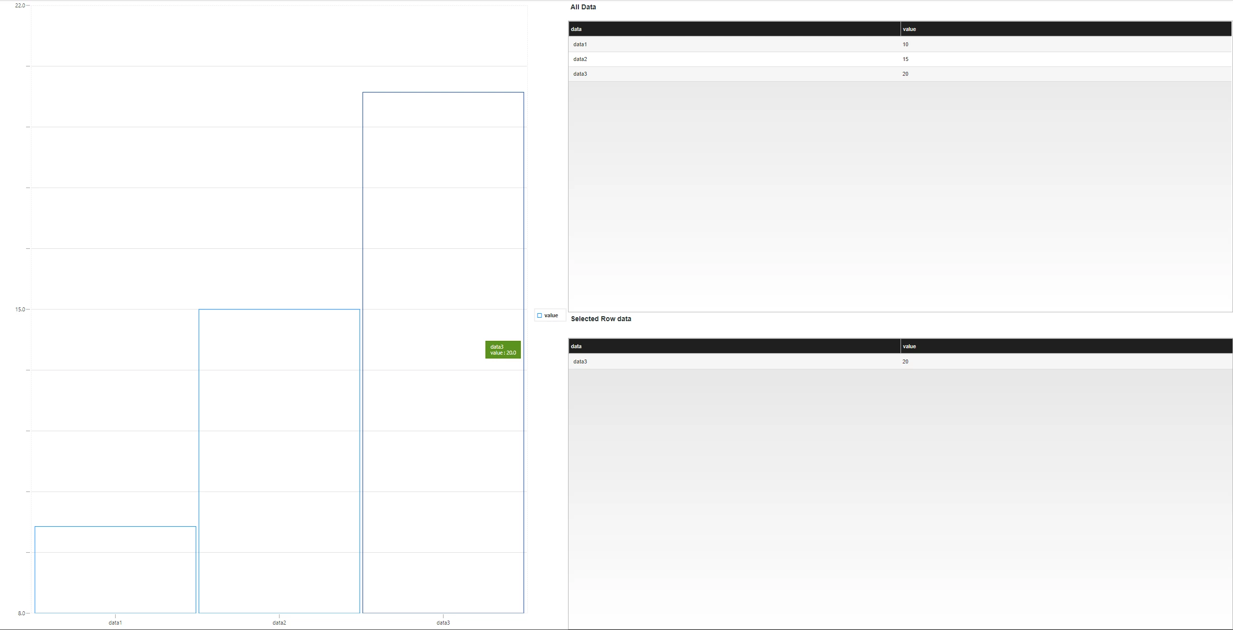

I created a test mashup, with a table data created from the service. I use the label chart to display the data in the table, and the results are similar. I can only select row data when I click on the bar chart border. It is not the same as the Thingworx 8.3 . I don't know if this is a bug or just a new chart design on thingworx 8.5.
Please check the attached file.
NBHD.

The chart is showing like this in my 8.5.4, I just imported it , did not change anything and I can select bar by clicking on the blue area.
Please check the Style Properties on your end, maybe there is something changed.
Hope it helps,
Raluca Edu
