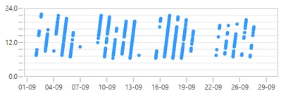

Hello
I need to show a chart that works exactly like X-Y chart, but with the possibility to show at the X asix a date string (or a timestamp) and on Y a value".
X-Y Chart does not allow to use string or timestamp on X ... this is the problem. This is what I get
Graphically it is OK, the problem is that X are "days" theoretically, but to get this "effect" I had to use a pure number, 1 to n (on picture X labels are hidden). But a number is not easy to unterstand as a date (expecially with hover values)

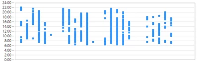

I tried so the Label Chart (with marker chart type) that is very flexible, but I get this ... because for each record it creates a new "label" so it "shift each new label right"

DAY    Y-VALUE   STATUS    X_VALUE_USED_FOR_XYCHART
01-09    0            Off               1
01-09    1            Off               1
01-09    2            Off                1
01-09    3            ON               1
01-09    4            ON               1
01-09    5            Off                1
02-09    1             Off               2
02-09    2              Off               2
02-09    3              ON               2
02-09    4              ON               2
02-09    5              Off               2
02-09    6              Off               2
02-09    7              Off               2
I can't find a chart that allows to obtain the label chart style, but with "vertical" lines.
It would be useful a label chart  widget that "aggregate" X values to the same column
or a X-Y chart allowing datetime or string as X values
Regards

Hello Ivano,
Here are few ideas, all of which may address your use case with different degree of ugliness:
  1. Bubble Chart widget with small fixed-size bubbles;
  2. Grid widget with 31 columns, 24 rows and state-based formatting for the cells;
  3. Collections widget doing the same as (2), but with more control over the content;
Constantine
