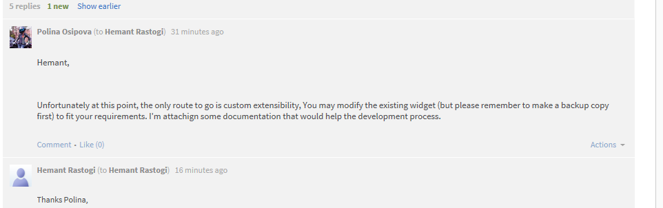

    May 8, 2017
    Hemant,
    Unfortunately at this point, the only route to go is custom extensibility, You may modify the existing widget (but please remember to make a backup copy first) to fit your requirements. I'm attachign some documentation that would help the development process.

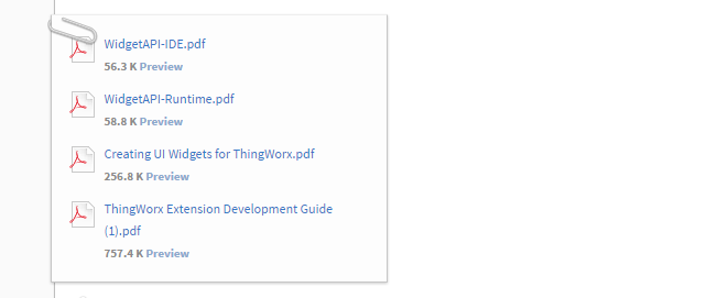

    20-Turquoise
    May 8, 2017
    I've attached the documents in my reply above - pelase let me know if you are able to access  them. Screenshot:
    hrastogi1-VisitorAuthor
    May 8, 2017
    Polina,
    Thanks again. I am able to see the screen shot, but I am not able to see a link or something else through which I can download the docs you have attached.
    Here is the information I see:
    If you need my email to send the information please let me know.
    Hemant
    20-Turquoise
    May 8, 2017
    Very strange! Please do share your email (you may do it through a direct message if you'd like) and I will send the documents.
