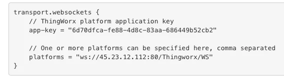

Launch IoT Hub Connector
Where I can find this values in thingworx.
transport.websockets {
 // ThingWorx platform application key
  app-key = "6d70dfca-fe88-4d8c-83aa-686449b52cb2"
 // One or more platforms can be specified here, comma separated
  platforms = "ws://45.23.12.112:80/Thingworx/WS"
Apr 3, 2018 9:44 AM UTC
Hi @pacho328 Application keys are listed in ThingWorx Composer > Security > Application Keys and the other is just the machine/instance's IP which is running ThingWorx. You could check the port in the server.xml available in tomcat's installation directory e.g \\Tomcat 8.5\conf
