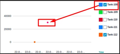

Legend Color and Line Color are not matching the LineChart
As shown below, Tank-108 is selected, which has the Legend color Blue, but as per the LineChart, it is showing Pink.
As you saw below Screenshot, the Legends colors are duplicated if the NumberOfSeries Property in the LineChart Widget is set to Auto
Thingworx Version: 9.3.2

@PEHOWE ,
You are right to a certain point, instead of removing the Specification color in the data  provided, we removed the default color assigned to the Series in the Style Properties of the Chart, that solved the issue. Due to Default color assigned to chart, there was a duplicity in the colors.

Hello @pshashipreetham,
Have you reviewed Article - CS341203 - Data line rendered in Line Chart widget doesn’t match the color of its corresponding legend under particular data condition in ThingWorx Platform
The description seems to be on point with the issue you describe.
Let me know what you find.

Hi @PEHOWE ,
The issue is similar, but as per the Article, that was corrected 9.2, but isn't should be corrected in 9.3.2(Which my team is using) ?

@Shashi_Preetham,
Are you trying to specify the color?  If you are specifying the color with your configuration, I will need to retest the issue.
