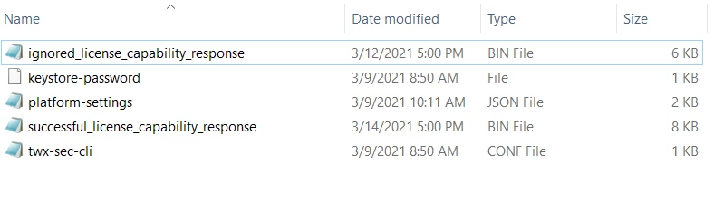

I have installed Thingworx 9.1 with Postgre SQL using Thingworx Foundation installer on last week. Installation was done successfully and license also applied. Today I have observed 2 license files.
ignored_license_capability_response.bin,successful_license_capability_response.bin. Why it is generated 2 license files. Please refer the attached screenshot. This is first time used Foundation installer on fresh system.

It appears that your first attempt to apply the license failed.  Two days later, it was successful.
You can safely remove the file called ignored_license_capability_response.bin.  It's best to never have more than one *.bin file in ThingworxPlatform.

First time it was successful. After that, It was generated ignored one file and successful one file.
I have confusion do I need to go with foundation installer or manual installation? Till Thingworx 8.5 including HA configuration, we have followed manual installation and generated license key manually in all dev and production environment.

You can use foundation installer, there should not be any issue. If the license file does not get generated automatically(connected mode), you can always generate a file manually(disconnected mode). Refer this article for licensing thingworx.

Still observing 2 license files generation one is with ignored and another one is with "successful" after deleting one is with ignored file generated earlier.
