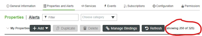

Hi all.
There are a limit of number of properties that we can see in the window of Composer, max. 250 bound properties.
Is this configurable or is the maximum that we can see in the Thingworx Composer??

Hello @jgp ,
Apologies!, Its internal only. However, I have cofirmed and the maximum value that is visible on one page is 250.
Let me know if you any further questions.

Hello @jgp ,
Yes, it is by default 250 and cannot be altered.  we can filter based on the category.
https://www.ptc.com/en/support/article/CS315131
Pls let me know if you need any further help.

Many thanks @bchaudhary_448008 , but I can't see the article, could you send me please??.
In the support page I have this message:
"Note: This article 315131 is not customer visible."
Best regards

Hello @jgp ,
