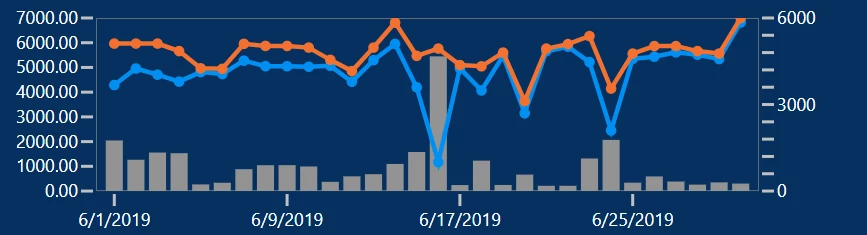

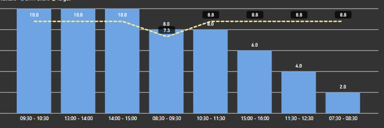

Is there any possibility to add both line and bar chart together in thingworx 9.1 version
Attached image for your reference

Hello Bhavya,
Yes it is quite possible. You just need 2 output to showcase on y axis and may be timestamp on x-axis. Few settings that you need are below:
1. ChartOrientation - Verticle
2. Chart Type = Line/Marker
3. SeriesType1 = Use CHart Settings
4. SeriesType2 = Bar ( whatever series you want to show as bar just select "bar" from dropdown)
In attached pic from my, I have 2 lines and 3rd one is bar. So in my case seriesType1 & seriesType2 are going to be "Use Chart Settings" and SeriesType3 is "Bar".
Attached is the output of the settings.

@BABA-SHYAM Thanks for the reply
I achieved this requirement in previous versions using label chart widget. But now i am using TW 9.1 version here we dont have label chart i found bar and line seperate charts.
May 7, 2021
I am not sure about your exact requirement, but did you check Pareto chart in ThingWorx 9.1?
