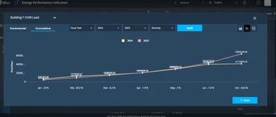

Observing overlapping of values in Line chart like below in Thingworx 9.3.0:
Please suggest if there is any way to avoid this by adjusting anything in chart properties.

Hi @krishnakomal211,
You can enable LegendFilter property to achieve allowing users to hide/display entire series through checkbox.
Alternatively, you can enable vertical zoom to allow users to zoom in vertically to take a closer look at some data points.
Also maybe try configuring SeriesStacking?

not quite sure. What you can do as workaround is not to show the value in the line chart. so they are only shown when the user hovers over the points. there is a config option for this (not sure of the name).
Nov 7, 2024 12:52 PM UTC
I can see HideValues property but It will completely hide values which is not desired.
Checked ValuesPosition property which helps whether to display values above,below or overlapped on line.
But I want ValuesPosition not for complete chart but for each Data series so that For one of the series I can select Above and for the other I can select below for better visibility of both values.Can you suggest any option or css for the same

That won't work, because your lines cross, even on your own screenshot. So you won't be able to say that for example the yellow line should always display the values above, and the red one -- below, because this would make sense only for the left half of this chart. You need to find a better idea.
