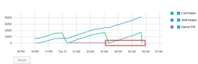

I have the attached Line Chart with 3 series and 3 sources. the data is only being logged on change but I would like to show the line (in this case Dancer PSI) to keep showing the line after the last logged value.
can this be done?

I don't know if there are any easy ootb ways nowadays in TWX since things have changed in the various releases.
But in the past I would basically determine the last timestamp and insert a point into the table being returned to the mashup.
