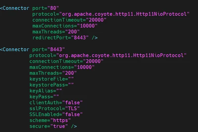

Linux - Tomcat - Port 80
I have changed the port to 80 in the server.xml:

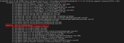

When I looked into the Catalina.out, I get the below error:
Does anyone know the solution?

I found the solution to this issue.
Below are the commands I have used to fix this issue:
Here are the steps to Java run on privileged ports in Linux:
NOTE: $SPECROOT is /usr/Spectrum (you may have installed Spectrum in a different directory)
1. The setcap sets the capabilities of each specified filename to the capabilities specified. In this case, allow java to bind on privileged ports:
$ sudo setcap cap_net_bind_service+ep /usr/Spectrum/Java/bin/java

The Tomcat service fails to start with this error message:
$ cat /usr/Spectrum/tomcat/logs/catalina.out
/usr/Spectrum/Java/bin/java: error while loading shared libraries: libjli.so: cannot open shared object file: No such file or directory
You will get the same error message if you run: "java -version" logged as Spectrum Install Owner account:
$ /usr/Spectrum/Java/bin/java -version
The above error means that after setting setcap, it breaks how java looks for its library to run. To fix this, we need to symlink the library it’s looking for into /usr/lib, then run ldconfig.
