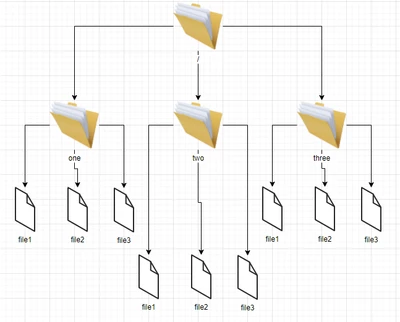

I need an infotable that has the path & filenames of all the files in a file repository, irrespective of the path.

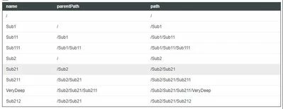

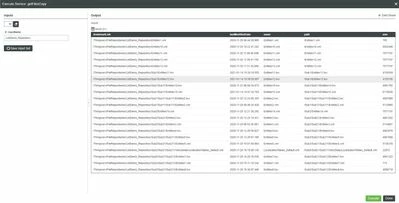

@SB_9732186 It works for arbitrary directory hierarchy.
The code gets the hierarchy from the GetDirectoryStructure and then just iterates over it. Here is the InfoTable returned by GetDirectoryStructure.
Here is a bit better commented code 🙂
var params = {
 infoTableName: "listFiles",
 dataShapeName: "FileSystemFileWithLinks"
// Initializing empty InfoTable with the appropriate shape
var listFiles = Resources["InfoTableFunctions"].CreateInfoTableFromDataShape(params);
// Getting the directory structure of the repo
var repoDirStructure = Things[repoName].GetDirectoryStructure();
// Iterating through all the directories in the repo
// and merging the list of files in each
for (var el in repoDirStructure.rows) {
 var listFiles2 = Things[repoName].GetFileListingWithLinks({
			path: repoDirStructure[el]["path"]
 var params = {t1: listFiles, t2: listFiles2};
	listFiles = Resources["InfoTableFunctions"].Union(params);
result = listFiles;

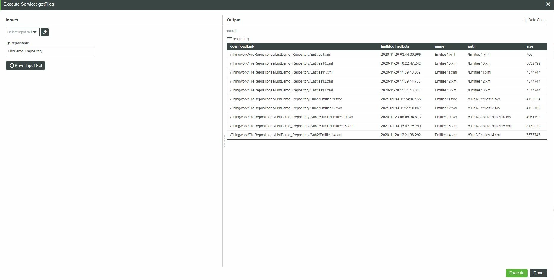

 The final result returned by the service:

Let me give you an example:
The service should return an infotable:
Path                                       Filename
/one                                       file1
/one                                       file2
/one                                       file3
/two                                       file1
/two                                       file2
/two                                       file3
/three                                    file1
/three                                    file2
/three                                    file3
Thanks.

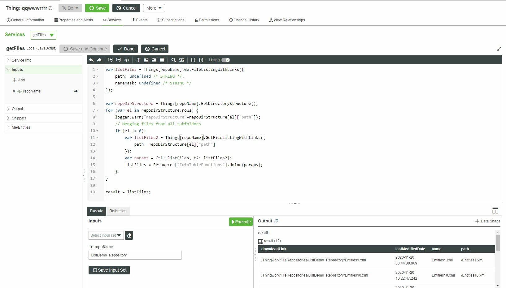

Is it what you're looking for?
var listFiles = Things[repoName].GetFileListingWithLinks({
 path: undefined /* STRING */,
 nameMask: undefined /* STRING */
 logger.warn("repoDirStructure"+repoDirStructure[el]["path"]);
 // Merging files from all subfolders
 if (el != 0){
result = listFiles;
Mar 4, 2021 2:31 PM UTC
if the approach mentioned by @DmitryTsarev works for you, then it is good as it seems to be more simpler and straight forward.
