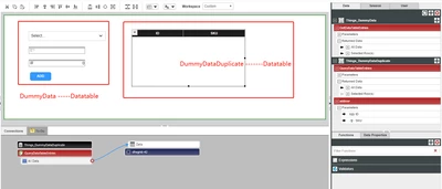

As Attached file below, I want to put DummyDataDatatable's data into DummyDataDuplicate. And Datashape is same. there are three types of widget: dropdown, textbox and numeric entry.
Now my process is:
1. I link dropdown list's value into textbox in DummyDataDatatable.
2. I drag textbox's data into DummyDataDuplicateDatatable's column SKU and ID also.
but after that, there is nothing in the DummyDataDuplicateDatatable.
Can Someone help me to figure it out?

Best answer by PaiChung
To Read/Write data from/into datatables you need to user services.
So to move the data, you would select data in one table, then write them to the other table, then do a re-read of the target table to show the new resulting content of that datatable.
PaiChung22-Sapphire IAnswer
22-Sapphire I
October 1, 2019

Hi can u show me an example for this method?
