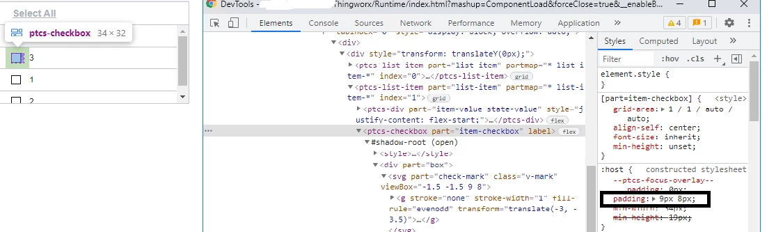

Thanks for your response. I have updated the row height property and applied the CSS modifying the padding. Still no changes could be observed. Please find attached image where the padding has been highlighted. I would like to have padding to be 3px all sides.
[cid:image001.png@01D77199.9A9797C0]
July 5, 2021
Attached snapshot

Could you please share the ThingWorx version info and export the entity for me to replicate the issue?
July 5, 2021
The Thingworx Version is 9.1.3-b593.
Please find attached entities
Support
July 6, 2021
Thanks for sharing the version info and entities. I can see the same CSS is working on Thingworx 8.5 but not on Thingworx 9.0 onwards including 9.1.3.
The difference I found in the HTML structure is that in Thingworx 8.5, ptcs-list-item element is enclosed in <div part="list-items-container"> </div>
whereas in Thingworx 9.1.3, the ptcs-list-item element is enclosed in <ptcs-v-scroller part="list-items-container"> </ptcs-v-scroller>
The issue might have to do with the nature of custom element list-items-container and need further research on how to style the child elements of list-items-container.
