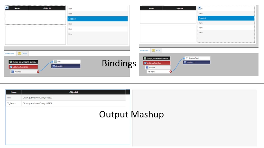

I have created a List widget and Grid widget, bound with ListSavedSearch (from Thingworx-ptc-windchill-demo-thing).
Grid widget is showing the Name and Object ID from my windchill saved search.
But List widget is not showing the list of names from my windchill saved search.

What is your List widget configuration (bottom left)?
Feb 16, 2019 10:40 AM UTC
for list widget you had to mention DisplayFiled & ValueField properties under properties section of list widget
