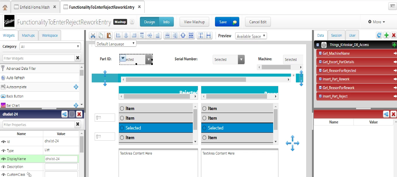

i am using thingworx 8.2 .my list widget is not working properly after i imported a set of entities for my new project . . i have attached two images here . one is my workspace (where you can see list widget is used and binded to data ) and other is my runtime view of mashup (list item is missing ) .  can you pls help me understand what might be the problem for this

What entities you imported? Maybe you need to redo the bindings.
Also, check the Application.log to get a hint what it happening and upload here any relevant error/warning.

i imported some entities like mashup , master, services , things etc for a project which has been created and shared by my colleague . I tried rebinding data also but its not working .
these are the error i am getting in application log :
2018-07-26 13:35:16.620+0530 [L: ERROR] [O: c.t.c.s.c.j.Jsr356ServerConnection] [I: ] [U: ] [S: ] [T: http-nio-8082-exec-14] Error [authenticating connection], Server websocket will be closed. cause: Application key 'RE_Kepware' expired!

Check the application key 'RE_Kepware', it is expired, don't know if you are using it in your mashup.
Change the expiration date and check again the mashup.
