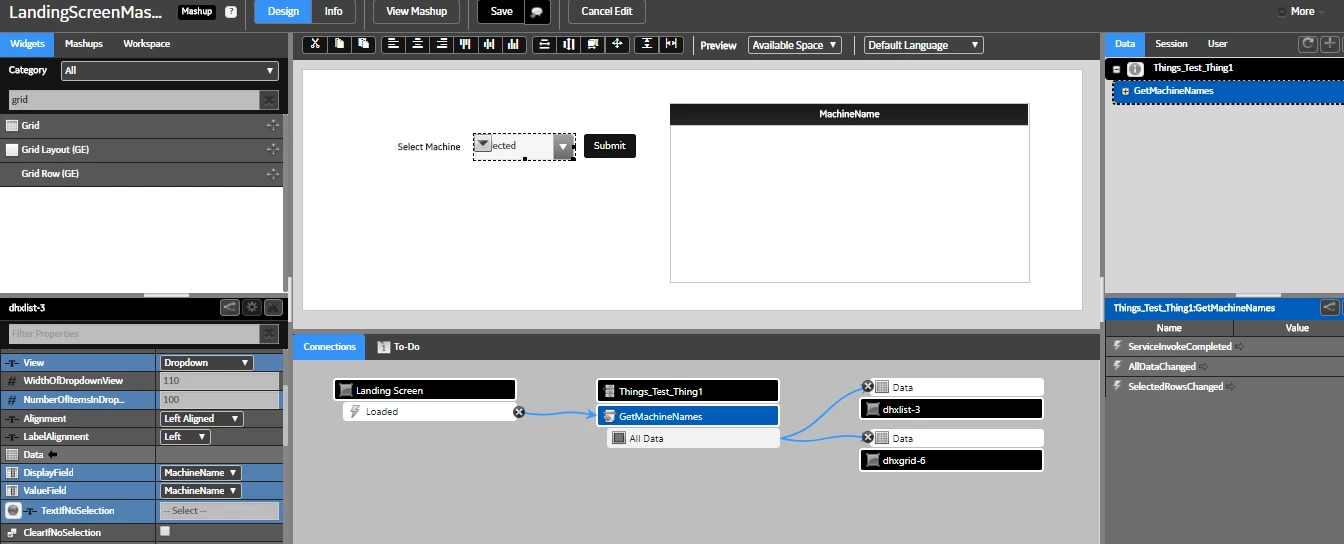

I have created a new Thing template service with return type as Info Table with data shape.

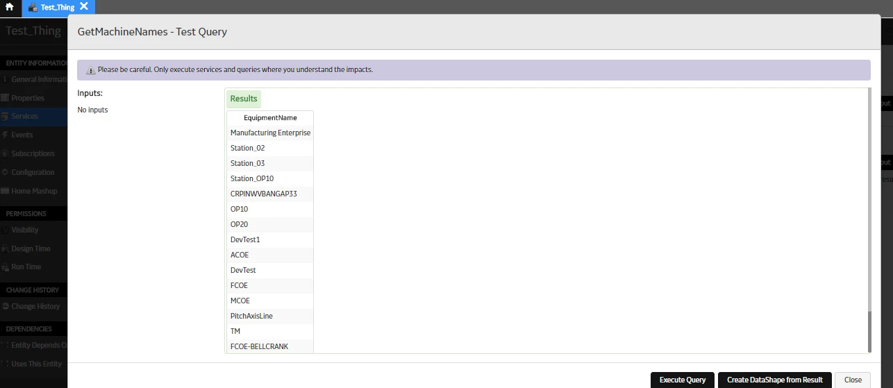

Created a new Thing and test service is returning expected values from SQL database.
When binding the data into List widget it only created 'N' number of empty rows based on number of rows from Service. I have already selected "DisplayField" and "ValueField" in List.
Kindly help me to sort out the problem.

The Problem is the name of column in Data Shape does not match to the name of the actual column .Do one thing ,create a new data shape and a field with name "EquipmentName" .I think this is matching to the column name from DB .Attach this new data shape to the service result and detach the existing service from mashup attach it again so that on grid it will show "EquipmentName" .By this way you will see data in the mashup.
