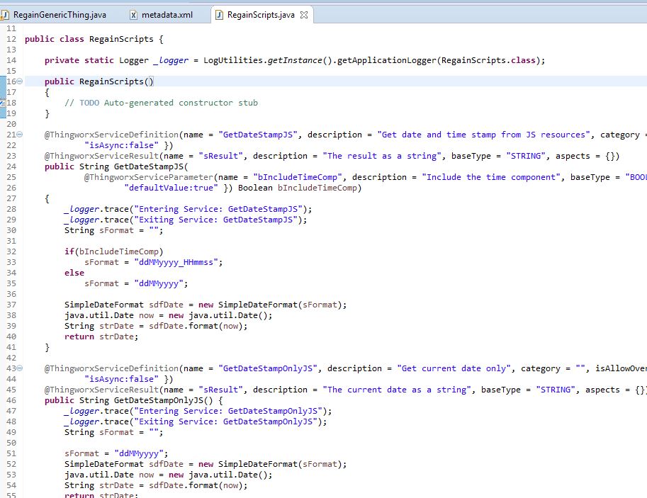

I am very new to both Thingworx and developing custom extensions and I have a few questions about things I have not been able to solve.
Essentially, I want to be able to access custom functions inside my services, be they javascript or java.I am very familiar with javascript and jquery and have my own library of js functions that I'd ideally like to use, but if that is not possible, I'm happy to translate them as I need into java functions.

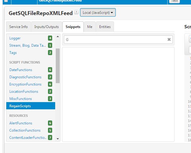

So to testy what is usable (and because I cannot find anything that is documented on how this works), I am going down the path of writing a custom extension and am able to do so, but how do I get my java functions/methods to show in the snippets section. I have added a "New Script Function Library" using the Eclipse Thingworx extension plugin and added services to thatCapture1.JPG
But when I import this into Thingworx, it shows the library but nothing below it.
If I try and insert a "New Resource" instead (as some info implies this is what is required), I cannot import. I always get the error
[message: [1,018] Data store unknown error: [Error occurred while accessing the model provider.]]
So what do I need to do to get things to appear in the snippets area. It will be onerous if all the functions are not viewable or we have to access them through a data shape or thing template.

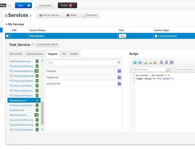

I did manage to get this working and should have posted my working as a reply to my own question. So I'll do it now so others may (or may not) benefit. I have the following as a resource in my extension.

I package that extension and import it into Thingworx and I finally get to see the functions
Thingworx Custom Resource
I did do this several months ago, some some step I must have performed that corrected my previous issues I cannot recall off the top of my head right now.
I can obviously piggy back from this base now and add all my existing javascript functions across to this resource as pure java functions.
The fundamental difference I see between this code and my previous code I posted is that here I extend Resource, whereas previously it was not an extended class. (But I may have made other fundamental changes)
