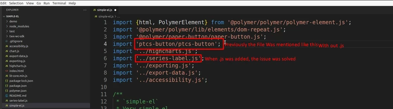

Found the solution,
Got this issue when we were using npm libraries in polymer.js. Instead of using npm libraries, we used the file.js file format
