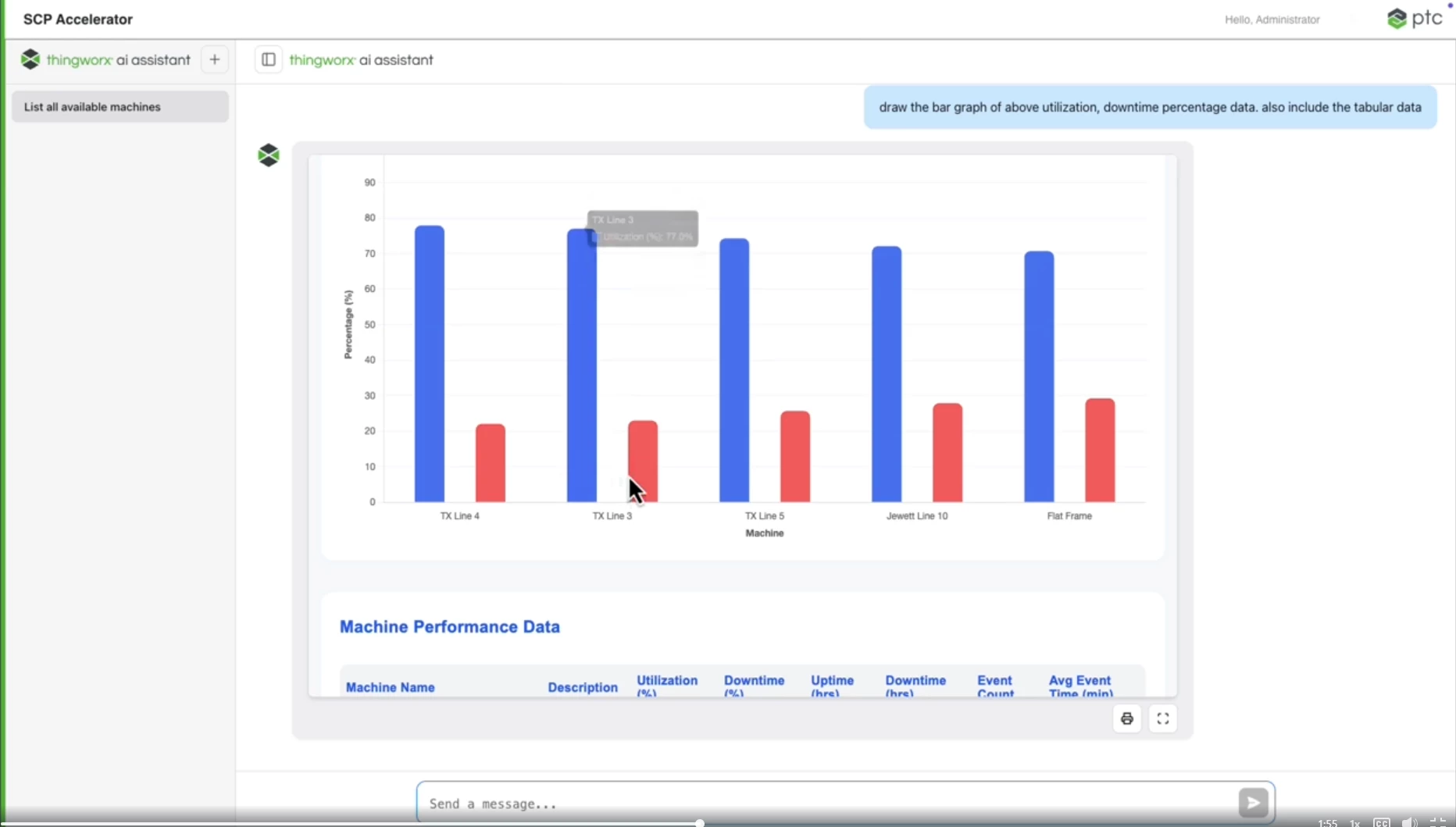

How can the LLM Accelerator be integrated with the native MCP capabilities introduced in ThingWorx 10.1 to enable interoperability with Mistral AI models? Additionally, are there any sample implementations or reference code available for building a chatbot within ThingWorx 10.1 and generating reports natively using these AI capabilities?

Jun 8, 2026 11:56 AM UTC
Thank you, Sharon, for your response. I was able to integrate Mistral with ThingWorx 10.1 and successfully invoke the Tools created in ThingWorx to retrieve some results. However, our requirement aligns more closely with the PTC demo, which showcases how an AI chatbot can pull data from an IoT application and generate reports on the fly. I have shared an image from the PTC demo below for reference.

Hey ​@RV_10930442,
The LLM Accelerator is quite old (in AI tech terms) and is just using API calls to communicate with Azure OpenAI. It was written well before MCP was on the table for ThingWorx and was not built with that type of connection in mind.
The best resource I can find regarding what you’re describing is in the ThingWorx Help Center MCP Sample Use Cases page. Specifically you’ll want to look at use case #3, which goes over making data resources available for the MCP client (and associated LLM) to pull from. You’ll have to change things around to match your specific use case, as the sample is utilizing VS Code and Claude desktop on the client end. However, creating the resource on the server for the client to utilize should be universal.
Unfortunately, there are no sample implementations available for MCP enabled AI chatbots.  ThingWorx does have built in functionality in the MCPService Resource entity to allow for Tool, Resource, and Prompt creation and management, but the individual components are left up to the implementer to add for their specific AI applications.
