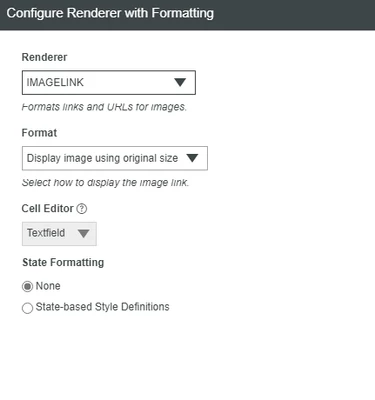

To display the image in the ValueDisplay, go to the ValueFormat widget property of ValueDisplay and press on the Renderer and State
and do the following configuration

So,
In the Service, I have written the following code:
result = "Thingworx/MediaEntities/ImageName"
And the output of the service should be ImageLink.
