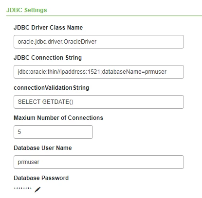

Hi everyone,
I'm unable to connect my local oracle db in thingworx platform.Please find the attachment of connection string for connection.Could please anyone help me out on this...
hchananaAnswer
December 27, 2018
Hi @Surekha,
Please validate the below points:
  • Make sure that Thing Template is of OracleDBServer type on your thing.
  • Oracle Database server is accessible from your thingworx instance. You can validate it by making ping to database server.
If you still face issue please share your error screenshot also. Also let us know to which version of oracle database you are making connection.

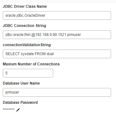

Hi @Surekha,
It seems to be an issue in the configuration. Can you please provide the configuration as below and validate :
JDBC Driver Class Name : oracle.jdbc.OracleDriver
JDBC Connection String : jdbc:oracle:thin:@localhost:1521:orcl
connectionValidationString : SELECT sysdate FROM dual
You need to change the localhost and orcl as per IP and SID of your oracle database.
Himanshu
Surekha1-VisitorAuthor
December 27, 2018
Hi @hchanana,
    Thank you for your response.I made changes which you have mentioned,but still it doesn't working.
