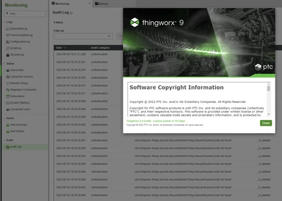

Localization Token Missing for Session Timeout Audit Message
As per the original post.
If we look into a .zip export of the audit logs I can see two variables:
	"message": "User session has expired.",
	"user": "RdmcInitUser"
I therefore created token 'com.thingworx.things.security.SecurityMonitorThing.SessionExpired.Audit' with value '__message__ For user __user__'.
Not sure if the missing token was fixed in a later TWX release (I am also on 9.3.4 where it is missing).

nmutter17-PeridotAuthor
May 30, 2023 5:34 PM UTC
Same issue in 9.4.0 (see in background the AuditLog with the "SessionExpired.Audit not found" error instead of the localized message:
I'll open a PTC case for it to get fixed.
nmutter17-PeridotAuthorAnswer
Jun 1, 2023 2:28 PM UTC
PTC article regarding issue: https://www.ptc.com/en/support/article/CS382527 The article will be updated when it was fixed. Article now also includes a workaround.
