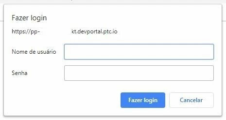

Hi there,
I am using the host free for 30 days.
I have created one dashboard and one user.
I was able to open this dashboard in other devide (tablet). To do it I copied the runtime's link and shared with my tablet.
When I opened the link was requested access credentials and the first time I missed the login and I was able to observe that no message was showed saying for example: "user or password incorrect".
Is there any way to change the login screen?
Leonardo.
Best answer by PaiChung
One of the easiest ways to get a nicer login  screen and interaction is to use an Organization and the FormLogin
<server>/Thingworx/FormLogin/NameOfOrganization
http://support.ptc.com/help/thingworx_hc/thingworx_8_hc/en/index.html#page/ThingWorx%2FHelp%2FComposer%2FSecurity%2FOrganizations%2FOrganizations.html
Please do note the impact on visibility, which you can 'turn off' by adding the 'Users' user group to your Org.

Hi @PaiChung
Thanks for your answer.
It helped me a lot.
