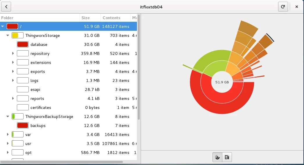

we have a bad situation for H2 DB Thingworx "Log".
They schedulated every days and after a week of Thingworx running, most of the memory is busy, like attached file.
How can we change the schedulation of Thingworx db log?
How can we change the path of schedulated logs?
Thank's a lot

One part is in the logging subsystem
the other part is in platform-settings.json

while, about the "backup" of H2 DB is it possible to redefine the scheduling?
We would like that:
1. 1 backup at day
2. Move old backup into another disk partition
Is it possible to automate this process?

I don't think there are any official instructions in this regards for the H2 database.
I don't know H2 well enough to be able to say that there is a good way to do it.
You could always do a filecopy of the database and just do a scheduled batch file
You can also create some services to do an Export of your entities and Data, to move it to another server, not sure.
could do filetransfer with an agent, could have your own file watcher/move routine.
