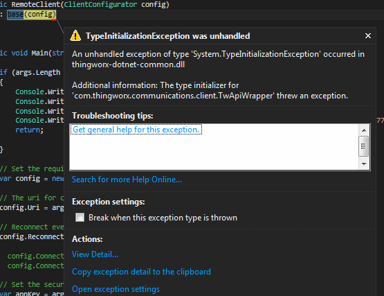

I'm trying to figure out how to log using the .NET SDK so far the only decent reference I came across is this link below:
.NET SDK Logging Configuration
However when I add this information to the App.config file (part of the file in the link above) I get several different exceptions. If I remove these then it'll compile but then there is no Log file/directory created. (If it is I can't find it anywhere)

What are the exceptions that you are seeing when you add the configuration given in that Community post?
Thanks!
Tori
jbennett11-VisitorAuthor
Jul 11, 2016 8:15 AM UTC
Hi Tori,
Hope all is well!, this is first point it breaks!
Kind regards
John

John,
If you use the entire app.config file provided in the example you linked in your original post do you still see the same errors?
Meghan

Hi guys,
Thanks for your replies, I've managed to figure out the correct App.Configuration code:

    <add name="file" type="com.thingworx.common.logging.FixedFieldTraceListener, thingworx-dotnet-common, Version=5.6.1.1100, Culture=neutral"/>
  </sharedListeners>
  <trace autoflush="true" indentsize="4" />
</system.diagnostics>
</configuration>
Not sure why it didn't like the last line PublicKeyToken=null" initializeData="false" ​but all is working now.
